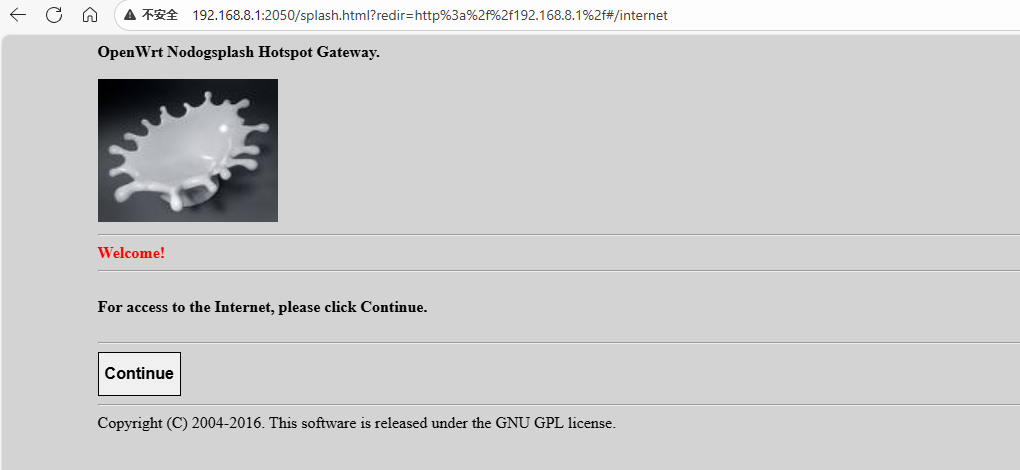

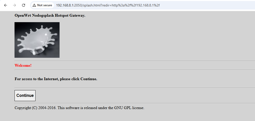

I verified noodogsplash on SFT1200, basic functions such as capture property or re-auth on time outs, they work fine:
A few times later:

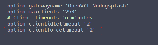

Please check this option clientforcetimeout in /etc/config/nodogsplash ,which force the clients to re-auth, for example 2 mins:
